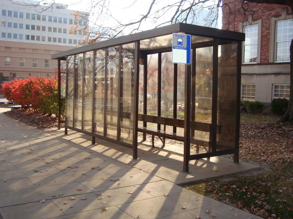

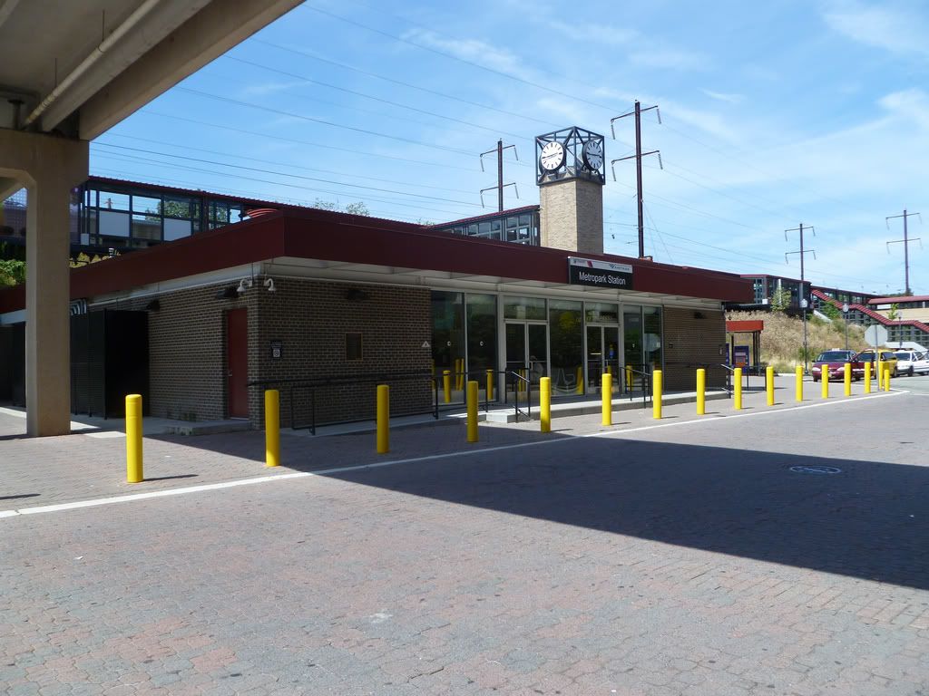

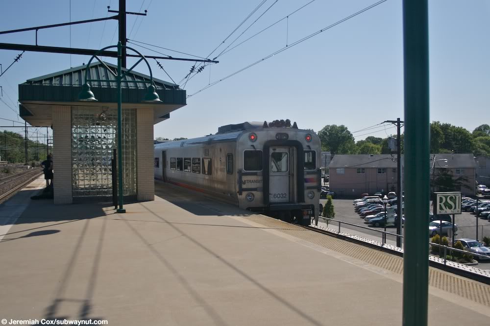

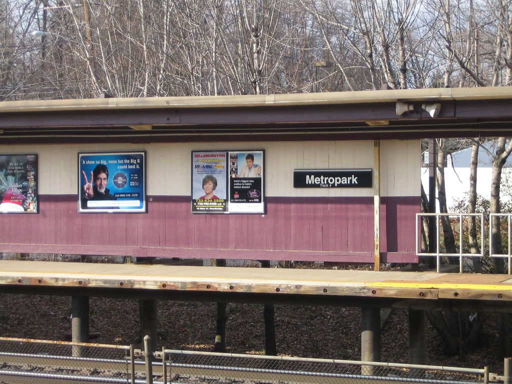

Are there vendors that’s out there that make shelter’s similar to those in these photographs? If not, I guess that thin plywood or any thinly cut wood would be good for the canopys of the MetroPark train station. How can you make pixie glass like replicas? I want shelters like the one in MetroPark and Rahway train stations. How can I make or where can I buy these? Can wood pass as concrete high level platforms when painted?

Tichy Trains makes window frames in all shapes and sizes. For the glass barriers on the platforms, get a frame and use clear plastic for the glass. If it’s visible from both sides, sandwich the clear plastic between two frames.
Distorted glass can be easily made using a product called “Canopy Cement.” It’s a glue which dries clear, used for the canopies on aircraft models. Take a window frame with very small panes and fill the window spaces in with the Canopy Cement. When it hardens, it will be distorted, but light will shine through.
