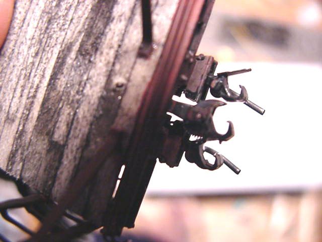

Sorry I’m a little late to this discussion. For a time I was considering dual gauge OPs on my (new) current layout. I built the RGM dual gauge idler car and did lay some dual gauge track. As the layout progressed, I found myself drawn to standard gauge and decided to make the narrow gauge a small, mainly cosmetic, part of the layout.
This decision was arrived at also in part due to the lack of West Coast narrow gauge equipment (that isn’t expensive, finicky brass) and the fact that there wasn’t much dual gauge OPs in CA, especially later in the 20th century… FWIW: The new Blackstone C-19 looks to bashable into a representation of some non-Colorado small steam…I have seen the beta test model run. It runs very well and the detail is great.
My layout is set in the CA foothills. I decided instead to focus on standard gauge short lines. I kept some of the dual gauge because it is cool and it does work in my Westside scene. The Westside Lumber Co.RR had some dual gauge trackage, though there was very little dual gauge activity other than switching…
I have used the idler car in mixed gauge switching and it does work pretty well. On the prototype car, the narrow gauge coupler could be moved from one side to the other and there was only one narrow gauge coupler per end. On the model this didn’t seem practical. I built mine with two narrow gauge couplers on each end (one per side).

More pics than you want…
