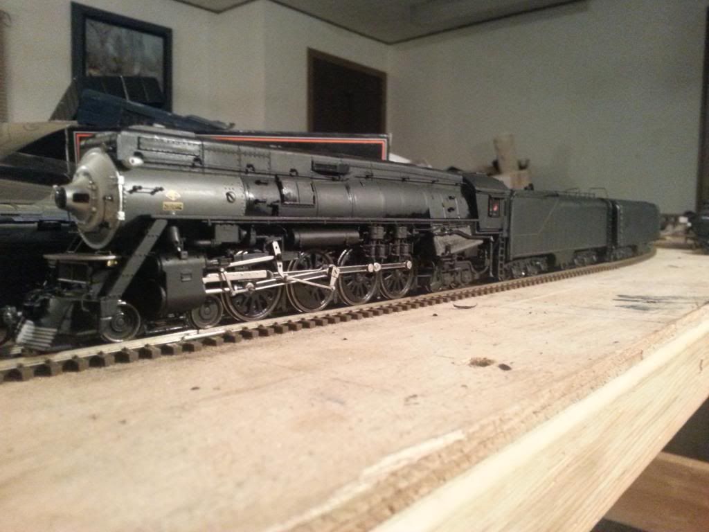

How the heck do I get the running gear off the boiler, or more the boiler off the running gear. I have to be missing something just absoulty stupid… I am going to add weight, and odds are take out the smoke unit too for even more weight.

IIRC, the GS6’s have three screws that hold the upper boiler/cab casting to the lower boiler/running gear. Two are located on the underside of the cab. The third screw is accesed from the top of the boiler and is concealed by a plastic detail part. The MTH GS4’s, J’s, NYC Hudson’s, and NYC Mohawks, all used a similar 3-screw design.

And plopping down at a fat 24 ouces! Added about 3.5 ounces to, and around the smoke unit to keep the lead driver down… hope it works. Dont get to test it till the 6th at the club.

No luck with NWSL. BUT the added wight work wonderfully, and the pulling power is much better. Plus it can now take a 20 degree curve… and that’s WOW for these norther’s. Went from 8 walthers passenger cars to 17… so I am happy with that on almost a 2 percent.
