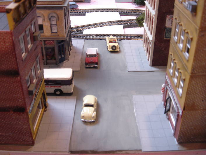

This urban street is 3 inches wide. As always, I was constrained for space, but I also wanted the narrow roads to enhance the image of the “brick canyons” of a city.
This is the cross street. Here, even more squeezed for space, I made the road only 2 1/2 inches. I also cut the sidewalks down to a half-inch. The result is an even more “claustrophobic” feeling, even though the buildings are only 2-4 stories.

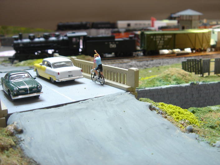

Away from the hustle and bustle of downtown, this RIX bridge is also 3 inches wide, so I kept the roads the same:
