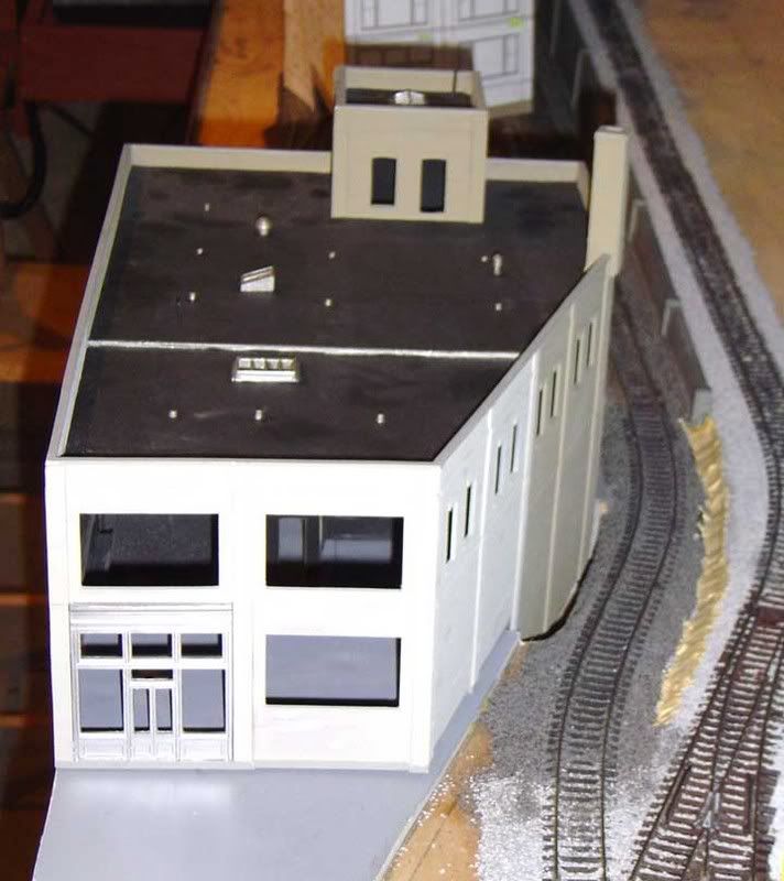

The detail on the drains is so small, I just cut up some sprue, glue in in place and paint a dark color. Kind of hard to see from this in progress photo from a few years ago of Sheepscott Transfer and Storage. I painted these old silver.
Not a bad idea. Do you have a close up of these?
I do not have a close up right now. I just cut chunks off a sprue that was 1/8" or slightly less in diameter, glued them in a pattern on the roof and painted them. To get them straight, I laid a grid with a ruler and pencil on the roof
