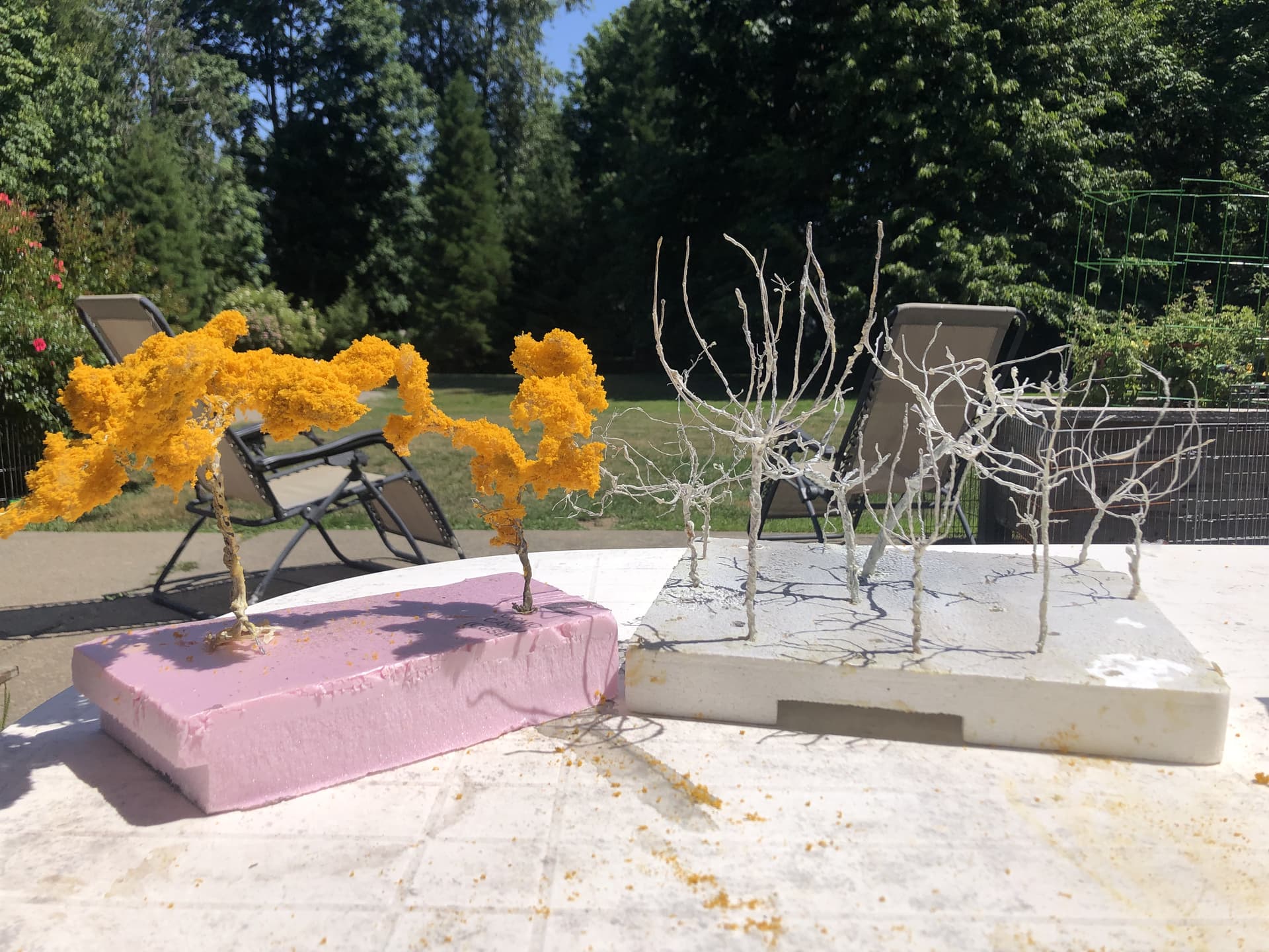

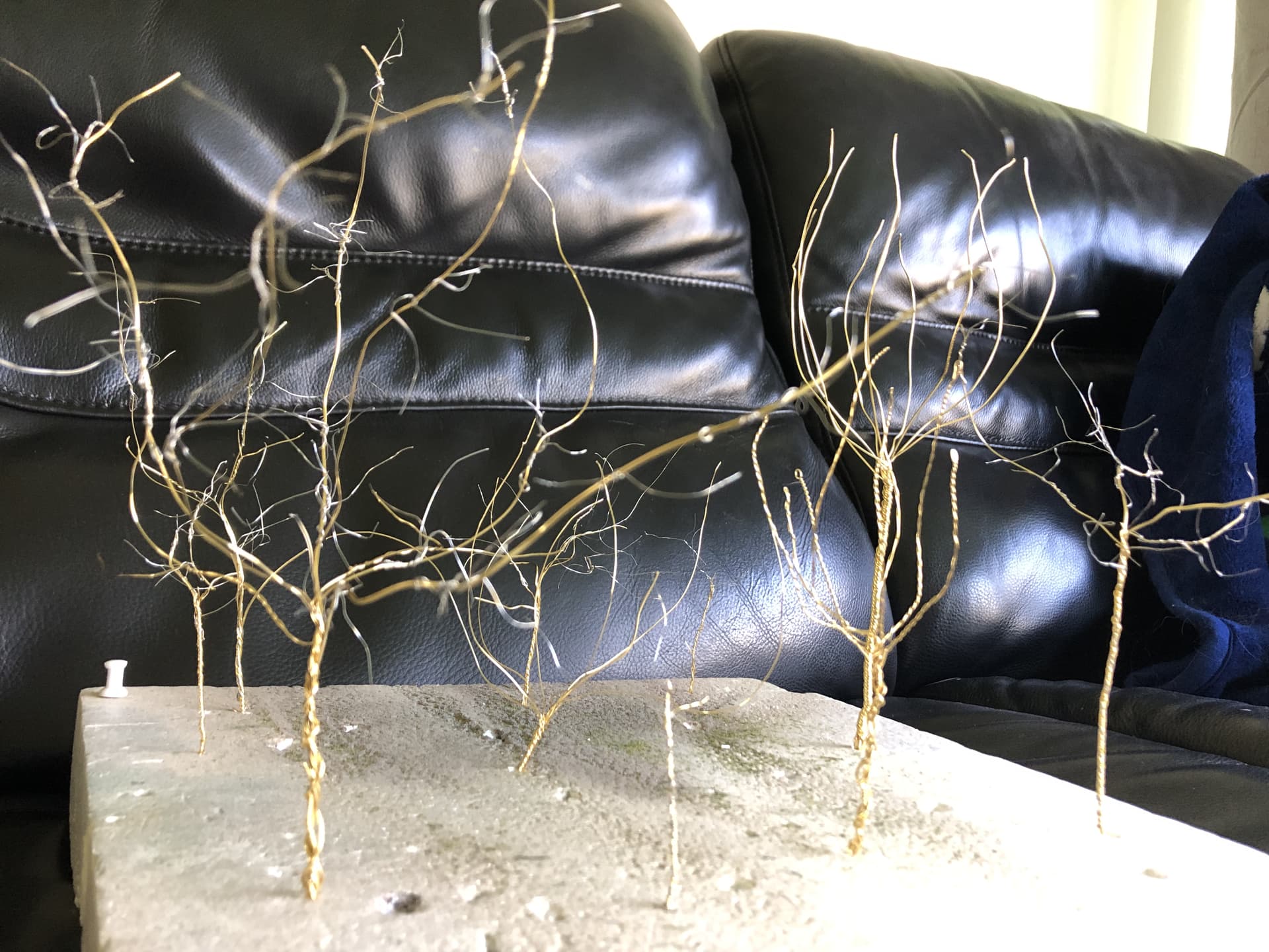

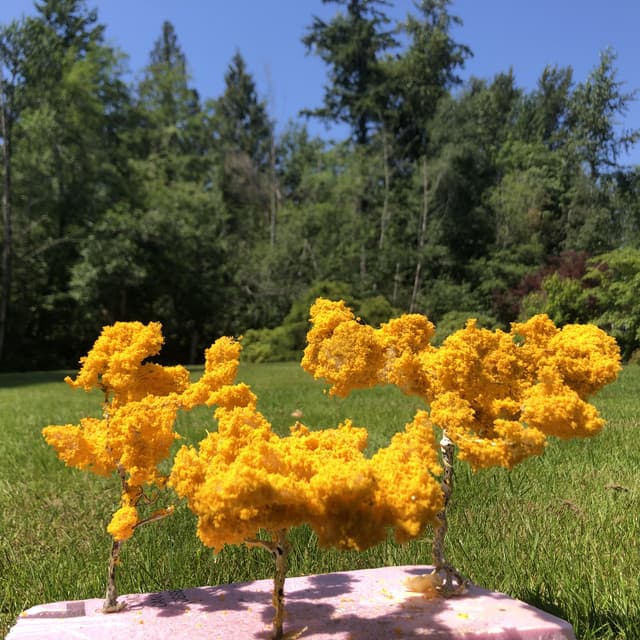

My trees are a constant work in progress. I use wire for my HO trees and they don’t look too bad. I have now grown Sea Foam and suspect they will be even better when I get around to trying birch trees.
Here are some pics of early efforts just using wire. I dip the trunks in Mold Builder to hide the wire, however in N scale you may not need to do that as the wire will be so fine.

Looks real good, Brent.
I suppose those on my N scale layout would be Young Birch Giganta Trees. Those are quite big.
