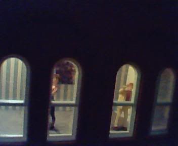

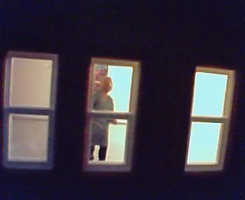

I went on my computer and designed walla and got some paintings off a program. I added chairs by Presier and figures from various companies heres a quick phot I had already posted earlier.
and upper layers
Luckily I saved what I did so I can change it around and add.
I am also working on Walthers White Tower Burgers but changing it into a music store such Sam goody etc.
