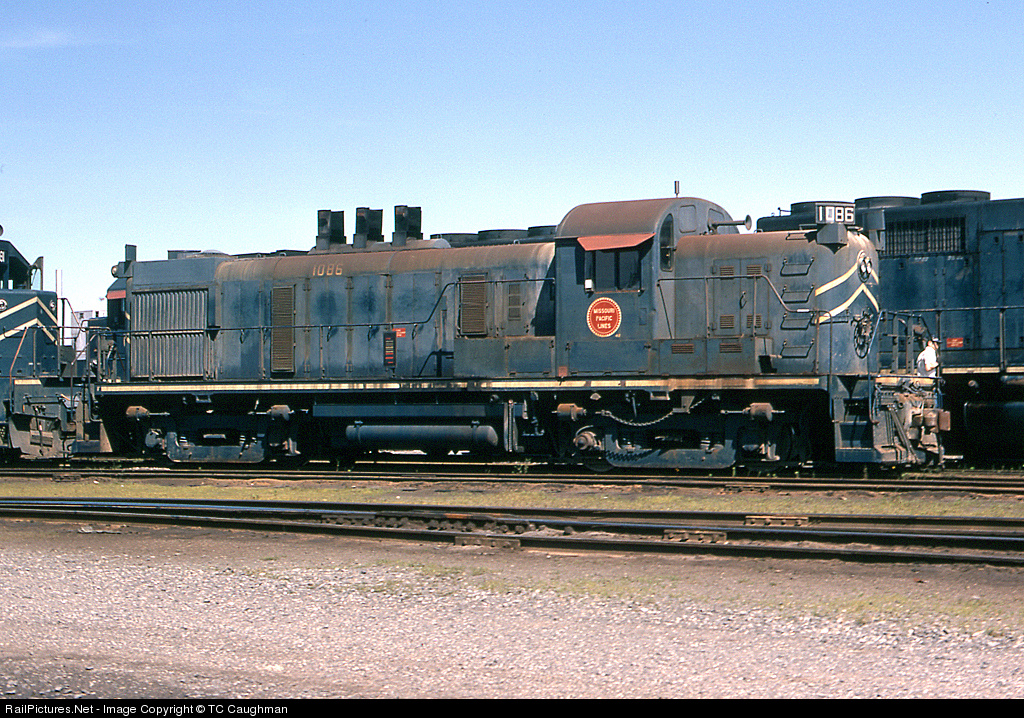

The MoPac converted most of their Alco power (RS types) to use GMD engines. In their case, the top had a bulge on it to house larger components (muffler?) and had the classic EMD exhaust stacks. If you do a search on line, you will come up with some photos. This would make a distinctive locomotive.
Like this re-build of the RS-3 (below)? I agree, it will make for a very unique model.
I’ve always had a soft spot for the ALCO re-builds. I’ve only seen the Pen Central/ Conrail re-builds, but I never seen the MoPac re-builds.
