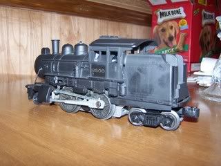

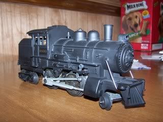

How many of us made our own engines? I made this one when I couldn’t afford a K-Line Tank engine. Now I’m kicking myself cause I should of found the money cause it seems like they’re getting rarer and rarer. But anyway I had fun making this one out of a Lionel 8500
I cut the cab off and moved it forward about a inch
Had a little mishap with the lamp used a bulb that got too hot distorted it a little

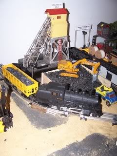

Cut a Marx tender in half and used a couple of plastic strips to take up the space. I even converted it from a manual switch to a E-Unit and it works good. Only thing no traction tire or magnatraction so she only pulls about 4 cars. She’s beat up and dirty looking but fit perfect in my coal yard.

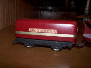

Don’t know if you would call this a home made or a restoration. Marx never made it but it has a couple of home made parts. When I got it, was nothing but a clump of rust and it ran but the main gear on the armiture was striped. So I figure since it’s missing a ton of parts and they’re a dime a dozen why not make it special. So I bead blasted it clean from rust and used auto body glazing putty to fill in the rust pitting. Primered it real good and then found a color that the can said tuscan but it’s has a little more red then I would have liked.
The hand rails are a coat hanger, a strand of copper wire wraped around and the bent like a cotter pin are holding it to the body, Domes and stack are hand made out of a plate of quarter inch aluminum and just hot glued in place.
The tender really had nothing wrong was just one I had lying around and was the worst one out of the bunch so it got a fresh coat of paint. Decals were just printed off of the computer.

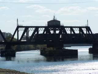

It’s in Philly. Their was alot of old warehouses back next to the river but they were torn down for the Fed-Ex hub and Trolley Works Hq. The have a swing bridge that is still in service and about 300 yards up river is one thats out of service it used to run a line right down Graysferry ave to Washington but the old timers in the area say it was put out of service in the 50’s. It’s a same wish I had taken pictures before the torn the warehouses down.
