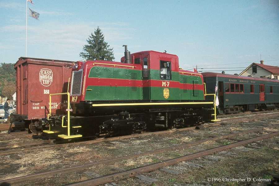

A narrow-gauge diesel looks more like this:

Narrow gauge diesels were around, but were mostly smaller types like the “critter” in the photo above–the East Broad Top photo is of what looks like a 44-tonner GE diesel-electric, which is very small by standard-gauge standards (an SW1 has about twice the horsepower) but pretty beefy by narrow-gauge standards.
