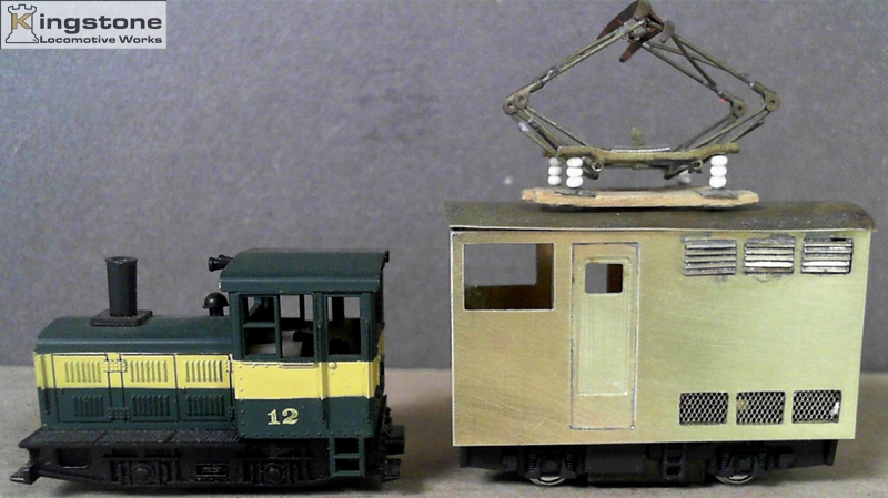

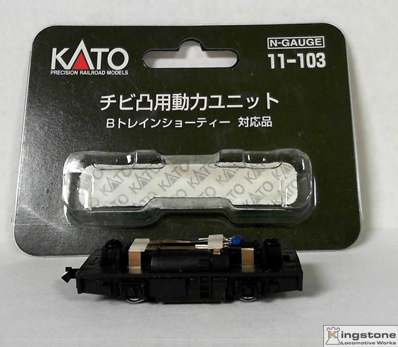

I’ve done some freelancing using Kato four wheel chassis’. I built four electric boxcabs.
Size comparison with a MTD Plymouth HOn30 switcher.
That’s Ted bending back the stirup tread. Those are scratch-built pantographs.
I also scratch-built a set of semipermenetly coupled diesel box-cab’s using the trucks from a DD-40 deisel.
