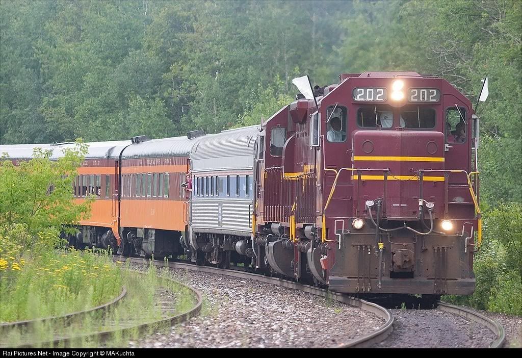

Well a note about air hoses: The DMIR uses what is called straight air. The locomotive has the regular and m.u. hoses on the plow, but the 2 straight air hoses are located on the guardrail.The ore cars and cabooses also had them.
Notice the two air hoses on the guardrail.
