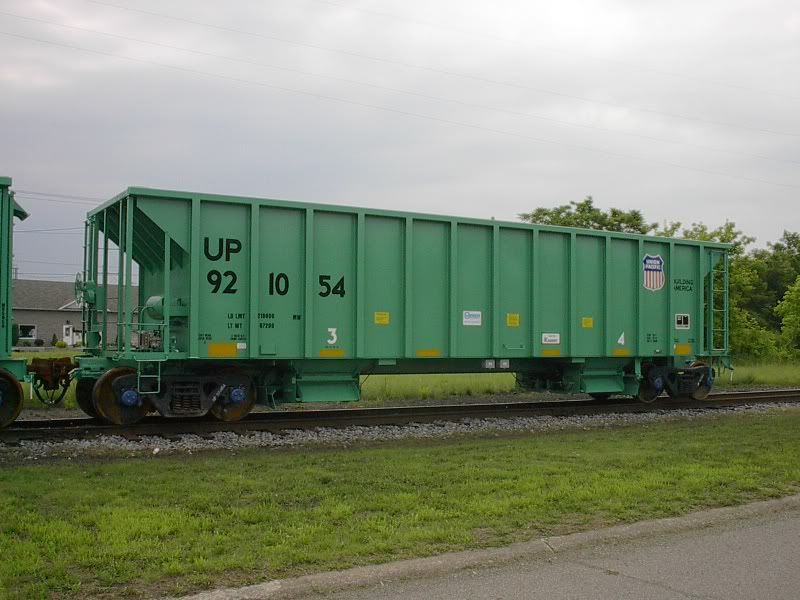

Here’s some photos I took a couple of weeks ago in New Castle, PA. This is where these hoppers were built. There were about 12 to 15 of them.
