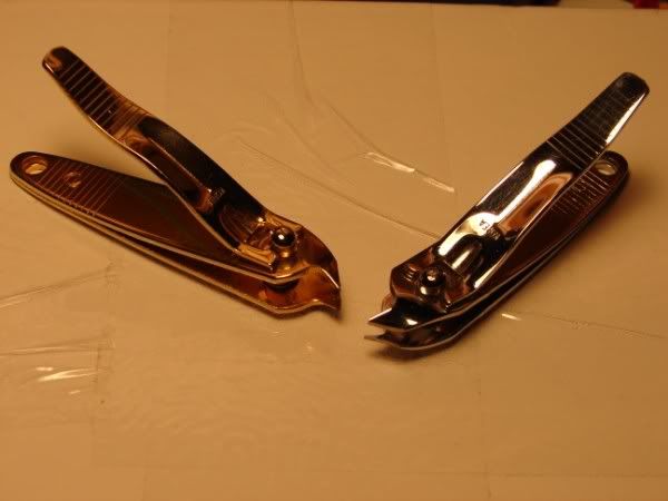

I Found these at My local Pharmacy, I can’t remember the exact name of them but they work really nice for cutting most parts off of sprues. The angle of them makes it easier to get into small areas…And they are under $5
