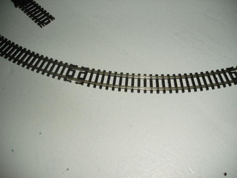

So I’ve been toying with the idea of putting up a version on the Carolina Central where the dining room table is in my apartment. I never entertain anyway so I figure why not ditch the one eating area I have. [;)] So while playing around with track layout ideas using Atlas’ track planning program I set up a loop around my Christmas tree, broke out a few freight cars and the three N scale locomotives I have to run around said tree. One locomotive will run for about a 5 inch length of track stop, move a tiny bit more only if I turn the throtle way high. I hear the motor turning and see it turning with the body shell off. It appears that one of the universal couplers is just spinning on it’s shaft and not actually turning the truck wheels. The other locomotive will only run long hood first and when it hits a specific section of track it kind of lurches. The track is Atlas sectional track code 80, it’s pinned to the board and the sections are tight…I even crimped down on the connectors but that didn’t change anything. See photos below.

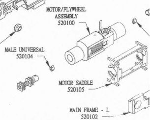

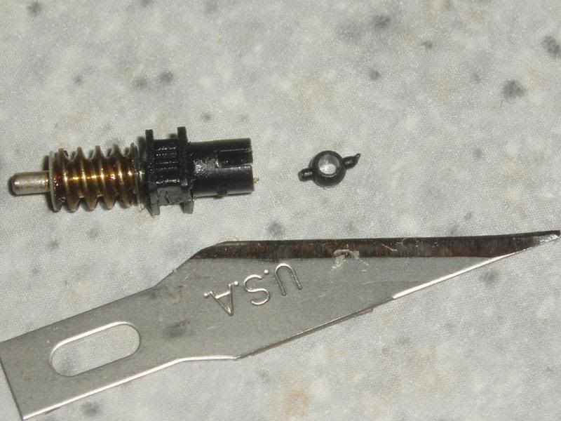

The Atlas h10-44’s, along with several other Atlas N scale locos, have a terrible problem with the splitting of a small driveshaft piece that resembles a doggone. This piece goes on the motor shaft and when its split, it will not turn the worm gear. It will just sit and spin. I have replaced these before and they are pretty easy to do. Call Atlas customer service and tell them what you need. I have also found that Northwest Short Line has these also, but I don’t remember the part number.
Ok, so for thosekeeping score at home, I figured out the problem with the loco that wouldn’t run at all. Checked the trucks and they spin nice a smooth with no binding at all. There is a tiny little plastic dogbone end that fits on a shaft that is recessed in the end of the fly wheel. it has a split in it and no longer holds tight to the shaft. To test my theory I ran it with only one worm gear powering one truck and it ran quite smoothly though a bit anemic on pulling force obviously 'cause only one truck is powered. So I guess I need to contact Atlas for a new dogbone thingy…Atlas calls it a male universal.

A dogbone is a drive shaft, with two thingy’s like that at each end,they are molded into one piece, that is just a universal thingy.[:D]
