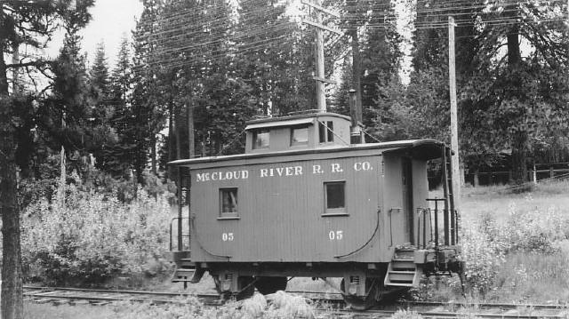

Four wheel cabeese were not unknown in the west. SP&S had 10 that they got from the NP in 1908. Two years later they were rebuilt into 8 wheel cabeese. And GN also had some in the olden days. They certainly didn’t last very long.
Here’s a shot of another on a western road:
Ed
