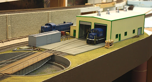

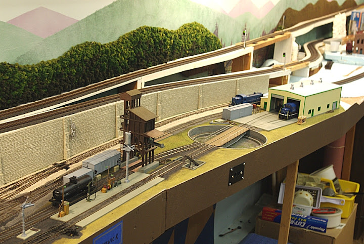

Mine has a block wall and gravel pit floor. I added a little grass to the pit floor after I saw Doctor Wayne’s. The scene is not finished yet and just has a basic scenery coat to get rid of the ‘blue foam’ look. I chose silver for the handrails and side girders. No weathering yet.
