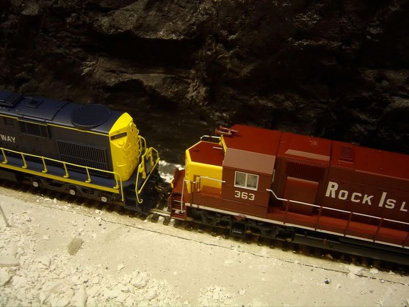

I have tried Joe Fugate’s spline roadbed and vermiculite mix on a testmodule. The problem I have is that the scenery close to the spline roadbed cracks. It’s where the spline roadbed meets the ground terrain. I do not want that to happen on the real layout. How can this be avoided? Look at the picture:

I just took another look at the picture…
Brakie will undoubtedly tell me off for advocating covering a crack that close to the ties with anything at all!
Okay, so my ideas work for cracks 6’ (1.8 metres [ish]) from the rail… use a wider spline so that the crack comes where you can hide it?
Actually my first thoughts were to just stuff the crack full of a flexible caulk that takes paint… then I moved on to wondering why it was cracking and came up with the plaster shrinking because of water loss (too fast while drying) and then stress in the spline structure… all of which got covered by other posts.
