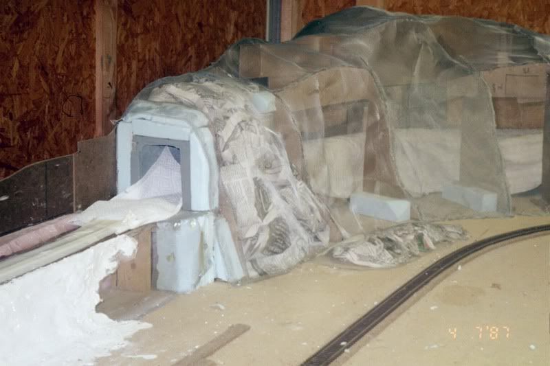

Forgot I had these old shots of building mine.
