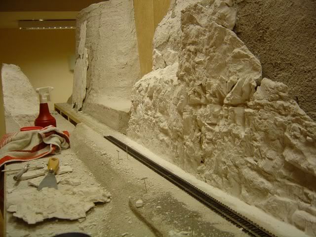

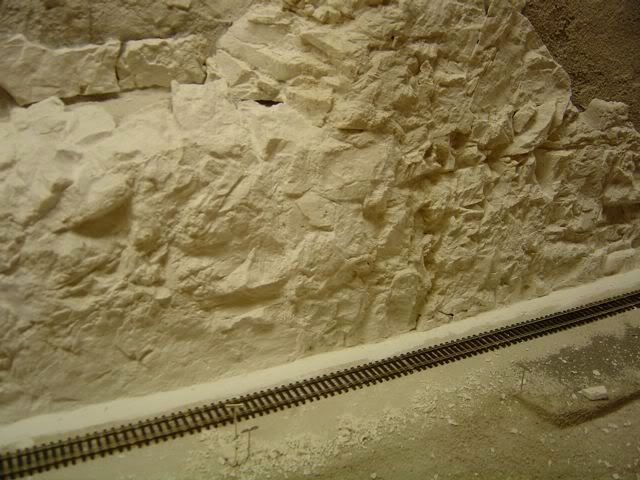

I’m casting a lot of rocks these days and wonder, how do I hide the seams between the individual rock castings? There must be proven methods. Here are two photos of my latest work. I’m dreaming about rocks [:D]
When I place rock castings, it’s either by placing them while still slightly wet in the molds or after they’ve totally dried.
When slightly wet in the mold, some plaster will seep out from the sides of the casting. After removing the mold, I carve the seeped out plaster so it resembles the other castings.
When completely dried, I attach the casting with either more plaster or an adhesive caulk. If I used plaster as an adhesive, some of it seeps out and I carve it just like from a wet mold. If I used caulk, I usually embed small pieces of broken castings into the caulk to help hide the seams.
When all else fails, I use a lot of ground foam to hide the seams! LOL

I use non-shrink acrylic spackle. Dry wall mud or a thick plaster mix will work too.

The first thing too avoid is seams occuring at regular intervals along or up the face. If this occurs it is all too easy for the face to look like a disguised brick wall.
Even when brilliantly disguised any movement/jolt or anything else that may shift the face may easily cause tiny cracks that start to show up the joints between the bricks.
So don’t install uniform length/height/size castings. Hacking the edges is a start to changing this. taking a number of castings and dropping them on a hard surface will do it even better!

It will also make you think far more about how you build up the face rather than just laying them brick-like.
The (broken) bits don’t need to butt up to each other… in fact it’s better if they don’t. It’s much easier to plaster in a hole than to squeeze filler into a narrow crack. In fact… it’s even better to widen out narrow cracks… the chamfered back edges gve more surface for filler to grip
Thanks guys for your answers. I will tell you all about a method I just tried. I patched the seam with plaster and let the plaster set so it’s rock hard. Then I used a flathead screwdriver and a knife, and started working just like a sculpturer. The plaster cracks in a natural way and after a while gave me a seam that locked very nice. Do you guys understand what I’m trying to explain? Is this a common method?

No, I did not hide the seam with a seam, even if that was what I said. I mean that the seam just disappear with this method.
I purchased an icing syringe ( the kind for decorating cakes ) at the dollar store. I just mix up some stiff plaster and squirt it into all the cracks. Before it has fully set, I carve it to match the adjoining rock castings.

The way you describe what you do is what I generally do. I fill any gaps with fresh plaster then once it has hardened, poke, prod, break off, and carve the seam to match the surrounding rocks.
However, since the material used for the rocks may be different than what was used for the seams, I find it best, once all the rockwork is done, to paint the entire rock wall first with a coat of acrylic paint using a neutral base color for my rocks, generally a light gray. Then stain and color the rocks from there.
By painting the rocks first, you seal them so the entire rock wall will take any further stain and coloring work in a consistant fashion across the entire rock wall. Otherwise, staining the rockwork directly may not look real great since the bits of rock castings you combined to make the wall will often absorb the stain differently and then make all your patchwork really obvious. Putting a coat of paint on over the rocks first works better.

What you are describing is known as zip texturing; if not invented by him then editor of Model Railroader magazine Linn Westcott was an ardent proponent of the technique and advocated its use in conjunction with hardshell scenery, another of his advocacies. I generally use putty knives, both narrow and broad, instead of screwdrivers and (regular) knives but sounds like we get the same effect.
