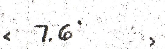

How do I read this measurement?
How do I read this measurement? It’s from an old drawing, but I think it’s hard to read it. I’m not used to feet and inches. I also wonder how we can post pictures at this new forum? I can’t just copy the img tag from photobucket as I did at the old forum, it will not work. As a test I post the img tag here directly from photobucket: Can you see the image? I can’t! It seems that the forum changed my tag, the tag I see now is not like the tag I pasted directly from photobucket. That’s the reason it does not work. What’s going on here?

I managed to copy and paste the “link” portion of the tag to view the pic, which looks like possibly old (and often still used) surveyor feet and tenth’s of a foot measurements. Modern surveyors sometimes use feet and hundredth’s of a foot.

twcenterprises: So this is maybe 7 feet and 6 tenth of a feet? The drawing is the D&RGW hanging bridge. I think that it was completed 1879. Can someone help a Swede that is used to centimeter to tell how many centimeter that is? According to my calculations. 7 feet = 213,36 cm 6 tenth of a feet = 18,288 cm 213,36 cm + 18,288 cm = 231,648 cm Is that correct?

To return to the original question before all the image posting hoo haa, I read it seven point six feet. Seven and six tenths feet. A lot of Civil engineering uses tenths of feet, as on a level rod used in surveying, et al, so it is not unreasonable that was the intent. And yes, 7.6 feet equals 231.648 cm. The decimal point is that little spot on the key, one to the right of the comma which you are using.

Hi Electrolove, the conversion from feet to CM is 30.48. So if you have a measurement of 7.6 feet, this would be 231.648cm
Electrolove, one more thing that you should be aware of, unless you already do, here in America we use the period “.” where Europe uses a “,” . If I were reading 231,648, I would have called that two hundred thirty one thousand, six hundred forty eight. By placing the period in the number, it seperates whole numbers from fractions of a number. For instance, 231.648 centimeters means…two hundred thirty one centimeters and 648 thousants of a centimeter.

Off topic sort of: Could the measurement be 7’ 6’’ I would check some of the surrounding numbers to confirm some of the ideas from above. OK All you Engineer guys: did you ever see or use a hand calculator called a CURTA 1 ? ? It 's the strangest hand held mechanical stepped calculator ever seen, go on the internet and find one.
TO CALCULATE METRIC FROM IMPERIAL IN THREE STEPS
1 Read the measure and take the number of feet and multiply by 12
example a 8’ 6" means 8 feet 6 inches - take the 8 feet multiplied by 12 becomes 96 inches. ,
example b 25’ 10" means 25 feet 10 inches - take the 25 feet multiplied by 12 becomes 300 inches
  1. Add the number of inches to the number of inches in the feet
example (a) 8’ 6" -take the 8 feet multiplied by 12 becomes 96 inches add 6 inches = 102 inches. ,
example (b) 25’ 10" - take the 25 feet multiplied by 12 becomes 300 inches add 10 inches = 310 inches
3 Multiply the total number of inches by 25.4 to give you millimetres or 2.54 to give you Centimetres
example (a) 8’ 6" = 102 inches. multiplied by 25.4 = 2590.8mm or 259.08cm or 2.509m,
example (b) 25’ 10" - = 310 inches multiplied by 25.4 = 7874mm or 787.4cm or 7.874m,
As you can see, all you need to do is move the decimal point. The hardest thing is to convert in your thinking. I just think the US should have converted when it was going to… it is much easier!
