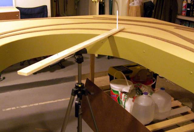

Along the yard stick idea, this proved invaluable for me. 48" piece of scrap with holes drilled (same size as pen) every 1 inch. “Ruler” has a hole for a nail, when center of circle is on “terra firma”. When center of circle is out in space, the tripod works just great. Needed a hole of a different size for the tripod mount but no big deal - what’s one more hole [:)]
