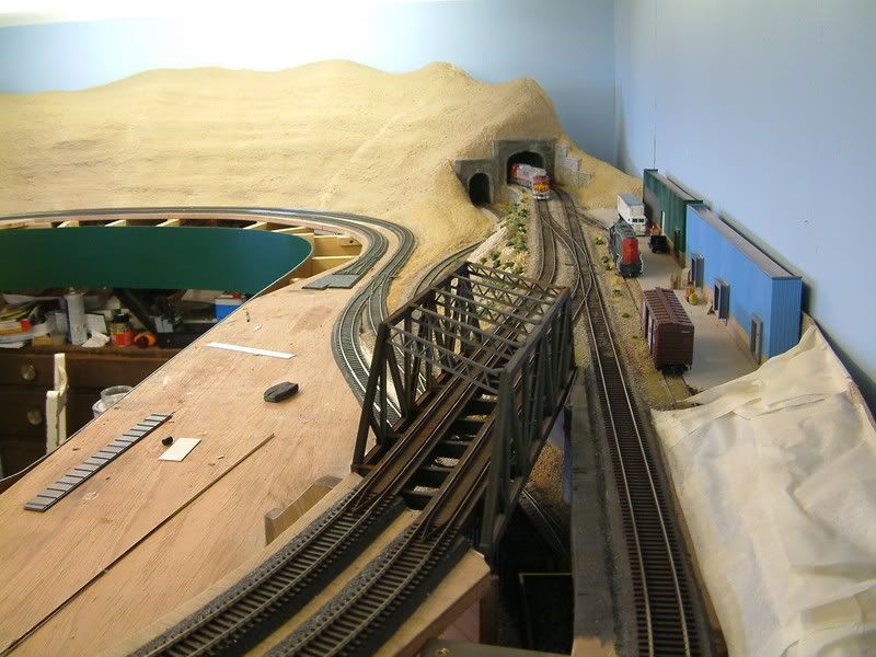

It depends alot on the constrction method of your bench work Jess.
For my layout i simply secured hardboard to the ends of the bearers that sit across the L girders. The screw heads were then simply filled before painting. If you look to the left in the picture, you’l hopefully see what i mean. The picture is one from my layout in its early days.

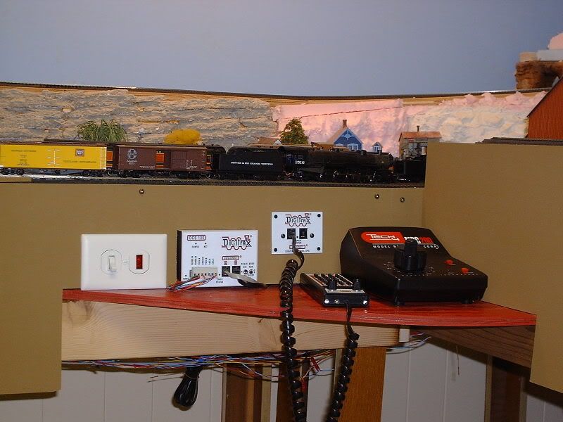

I use 1/8" Masonite hardboard painted black and secured with wallboard screws:

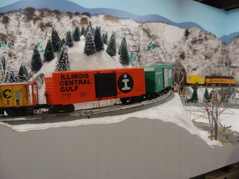

I use WHITE ICE paneling for fascia board, and profile the layout edge with contours, to break away from the running along the edges look.
