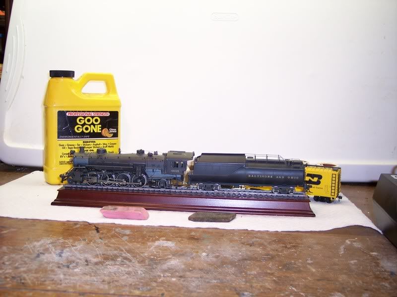

There are some that don’t approve of using Goo Gone, but I have done this for a long time and it works both for rolling stock and motive power, as well as cleaning track. There are those who will say don’t use Goo Gone, but I can tell you from years of experience it has served me well. You can use other materials as track cleaning fluid. Micro Mark has a complete set up to do this.
This is some of what I use.
I take a section of track cover part of it with a paper towel and soak it with Goo Gone. I then place the motive power, let’s say the front truck on the paper towel and the back set of trucks on the powered track. I hold the paper towel with one hand and the engine with the other, after turning on the power, allowing the wheels to turn riding on the soaked paper towel.
I then turn the engine around and do the other trucks. I can also do this with steam.
Rolling stock is done with my hand rolling the car over the soaked paper towel of Goo Gone, the dirt comes off the truck tires. After cleaning the wheels I clean the track.
Either with a track cleaning car and or eraser, as well as use the track cleaning bar.
I also have a track cleaning car, whereby I can soak weighted rollers, again with Goo Gone, and pull them along the track in a specially made car.
After all of this, I place LaBelle 101 oil around the layo

Heres my set up for cleaning my loco’s and what i use for cleaner
