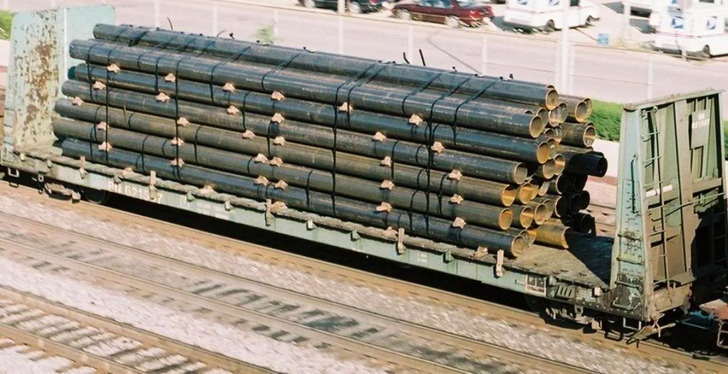

Here is a load of straws for ya from the 17th Street Bridge in Altoona, PA August 2004.
Digging through my box of random stuff I found a straw from work. Cut and test fitted to my 60’ bulkhead and sure enough, it looks just right for the job.
