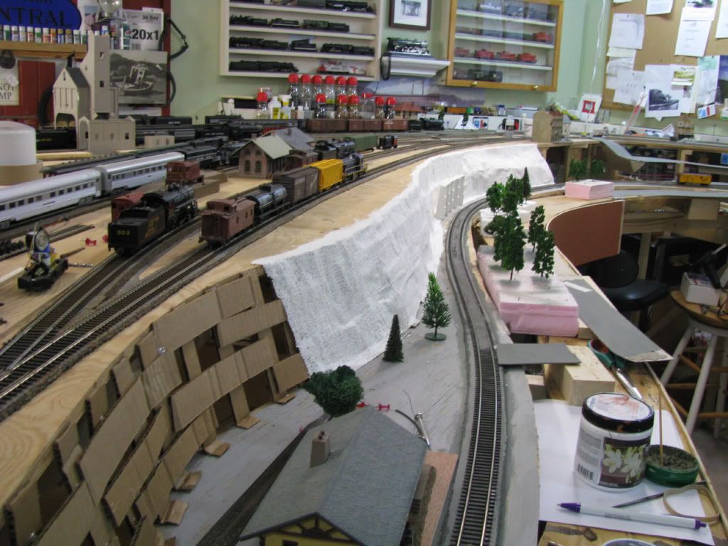

I would suggest putting your strips closer together. I sometimes have a solid carboard surface to put the plaster strips on. Cardboard is cheap and you can create almost any terrain you want by adding strips over others. This is a section of my layout where I have steep drops and I wind up with carve rock surfaces using sculptmold over the plaster. The sculptamold is easy to shape and carve as it sets.
-Bob

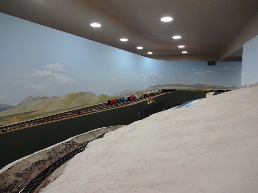

The initial plaster surface shouldn’t be expected to come out smooth. I mix stiff batches of plaster (maybe 2:1 plaster:water) and use it to fill and finish the scenery shell.
Here’s a scene in the process of getting smoothed out. The finish coat is progressing toward the foreground.
This is the same location after the plaster was finished and painted, so it’s ready for ground cover. The completed shell isn’t perfectly smooth (and really shouldn’t be), but the unrealitic irregularities are gone.
