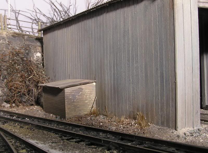

One thing I always do to make a building or road - whatever it is - belong is to give it some of the same colour as its surrounds. If you have green grass right up to the walls, add some green. If it’s dirt, add dirt colour. If it’s dry grass, add some dry grass colour. I apply the appropriate colour pastel dust down low on walls to do the job. That makes it belong to the current colour scheme, so it doesn’t stick out like a sore thumb.
But I probably should have had foundations showing too [:)]
