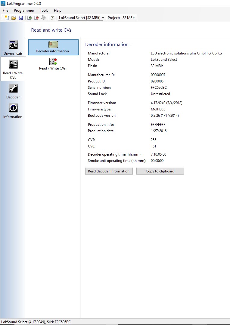

Don’t decoders have run time on them?
The only easily accessible one I’ve come across is ESU. You can read it with the Lok Programmer.
Toward the bottom of the Information tab:
ESU_hour by Edmund, on Flickr
Cheers, Ed
