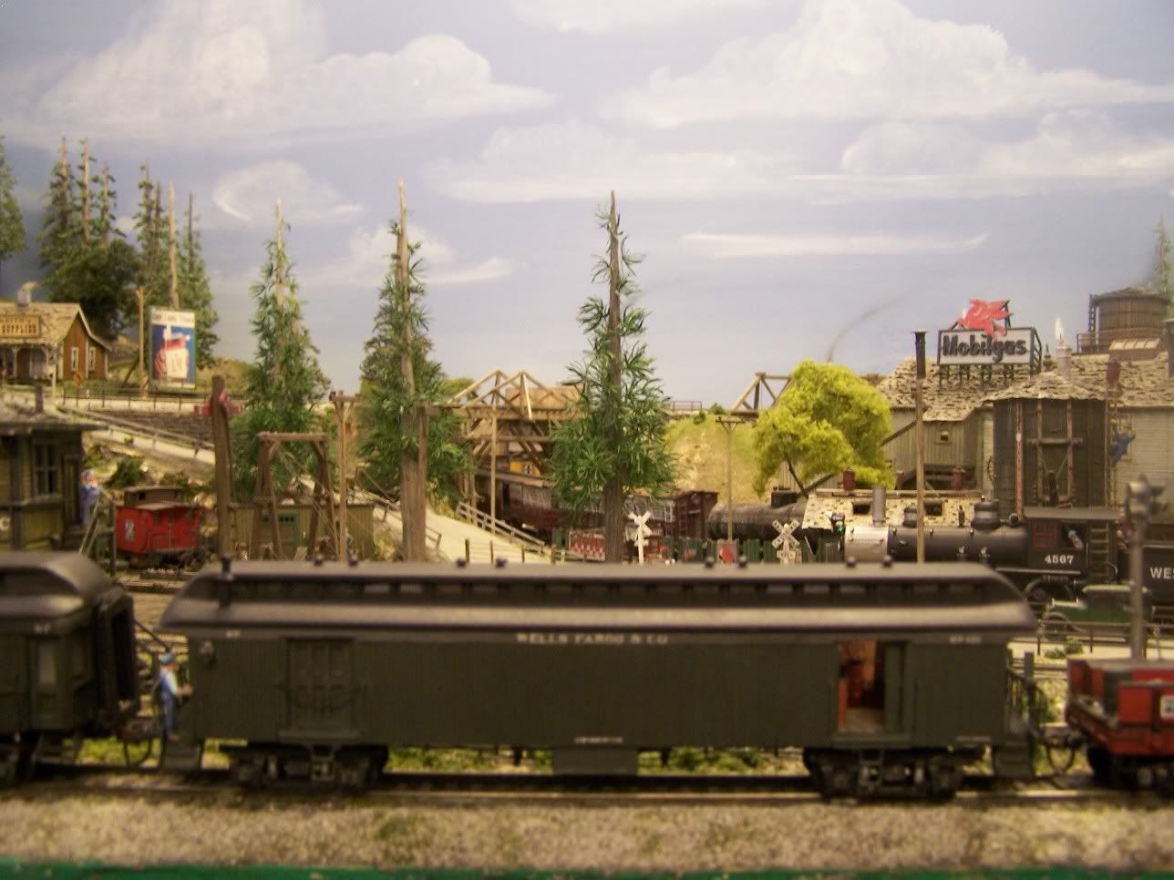

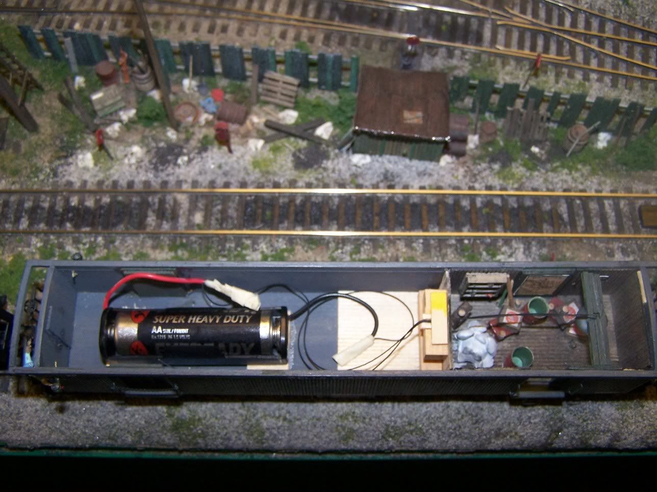

Here are pics showing how I detailed this La Belle 50’ (open platform) baggage car. BTW, building a La Belle kit is as close as you can get to scratchbuilding without having to figure out which materials you need. Everything you need is included. The kit, as built per instructions looks great. But the detail “freak” in me said, “something was missing”. That something was interior detail. Not wanted to detail the whole car, I devised a partition wall that was used as a view block. This allowed me to use the unseen portion of the car to house a 1.5 volt battery holder to power the GOW bulb. The car has quickly become a favorite among my visitors.
The first shot shows the car with roof removed.

This last shot shows the car as seen from a normal distance.
A question, if I may: Why did you choose to go with a batttery, which must be replaced on occasion, rather than picking up track power? I’ve been addijng interior lights to my mini-fleet of Mantua streamlined passenger cars, and I’m happy with taking track power and living with occasional flickering.
I once tried the rail pick-up method, but was unhappy with the results. For one, as you made mention, I did not like the flickering effect. Second, this allows the car to stay lit even when there is no power to the rails.

Beautiful. I’m still curious about the battery. Did you install a switch to turn it off?

Since the roof is removable, I did not bother installing an on/off switch. I just simply remove the battery from its holder.
