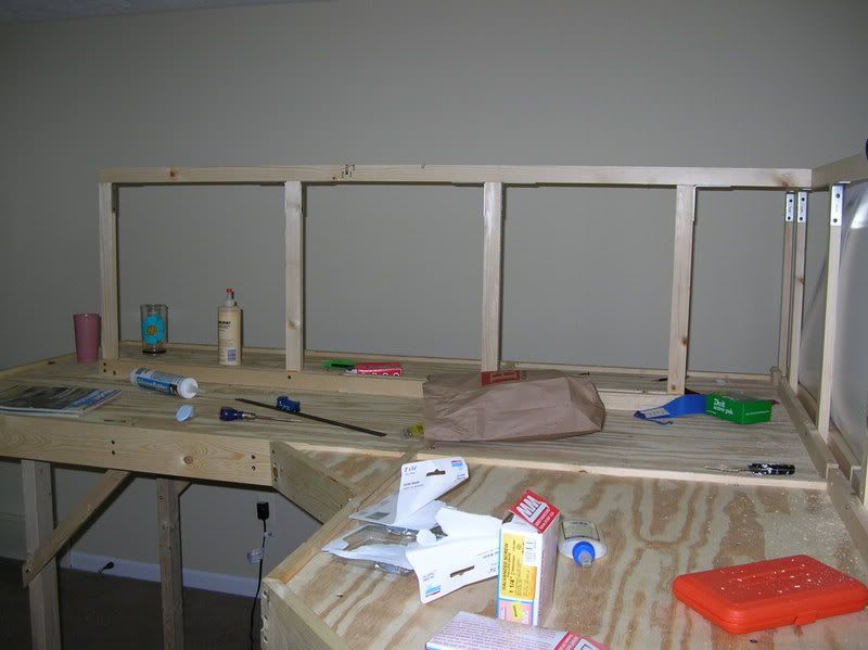

I’ve been asked a few times to share how I built and painted my backdrop and I promised to do so once I finished, so here it is! (click any of the pics to enlarge them)
I started out by making the support tracks that will hold everything up. They are simply 1x2s secured with drywall screws and wood glue. Even though they are raised 3/4" off the benchwork, I wasn’t too concerned about hiding them since they will be covered up by mountains when I start scenery.
Next I installed the actual supports, which are more 1x2s and metal L brackets. I made sure there was a support every 12", although if I had to do it again there would be a support at least every 8" for reasons I’ll explain later.
After all the supports were up, I installed the actual backdrop. When I started planning for the backdrop, I was very concerned about cost and ease of use. I wanted to use styrene sheets, but it would cost me over $100 and it didn’t seem very easy to work with. Then one of the forum members suggested vinyl flashing. After some research, I found that it was relatively inexpensive, and it came in a role (up to 50 feet) so I wouldn’t have to cover up any seams. Here is a link to the product I used. http://www.diyhomecenter.com/products/building_supplies/flashing/duraflash/detail.aspx?iid=10021
(Btw, if you do order any, I highly recommend getting it from this site. Free shipping and it was on my door step the next day!)
After roughing up the back of the flashing with sandpaper, I used Liquid Nails for Projects to secure it to the supports. It helps a lot to have 8 or more clamps to hold everything together while the caulk sets. For the very bottom of the backdrop where appearance didn’t really matter I used drywall scr
