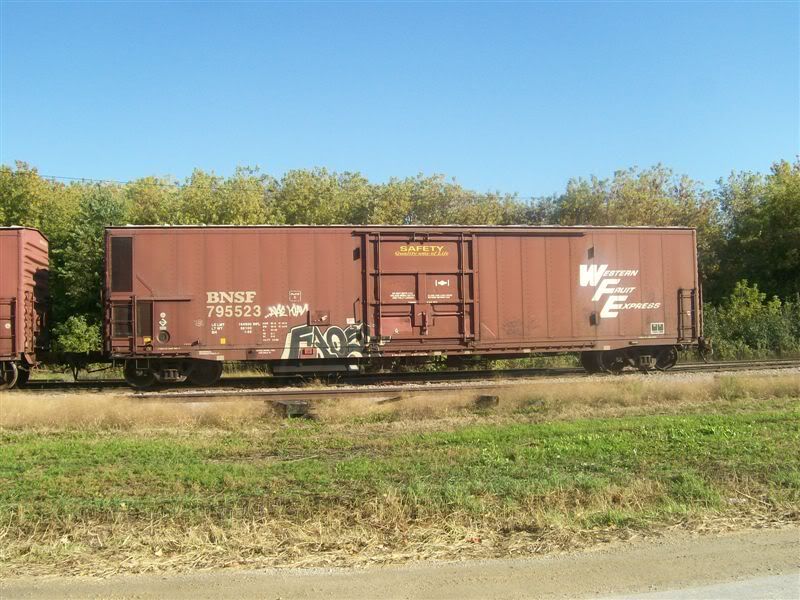

Not directly related, but BNSF is still using Western Fruit Express on some cars.
