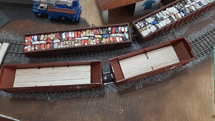

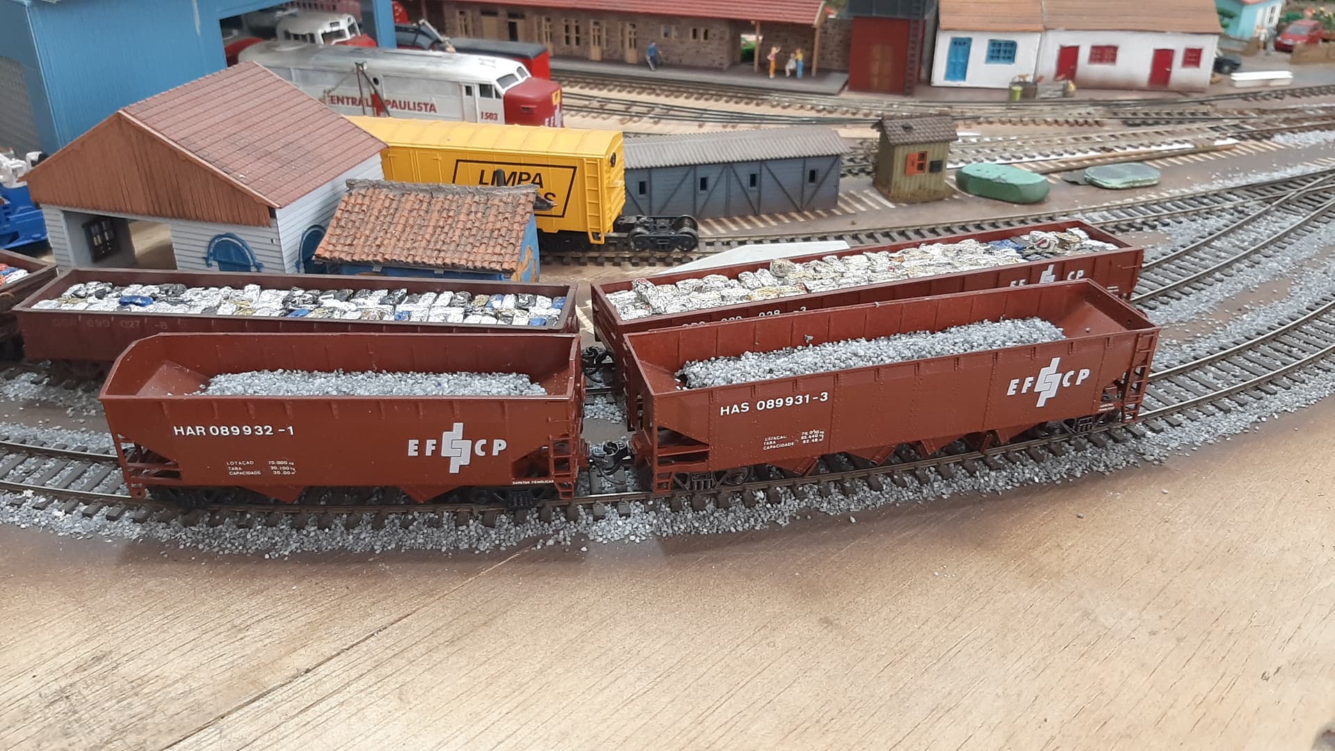

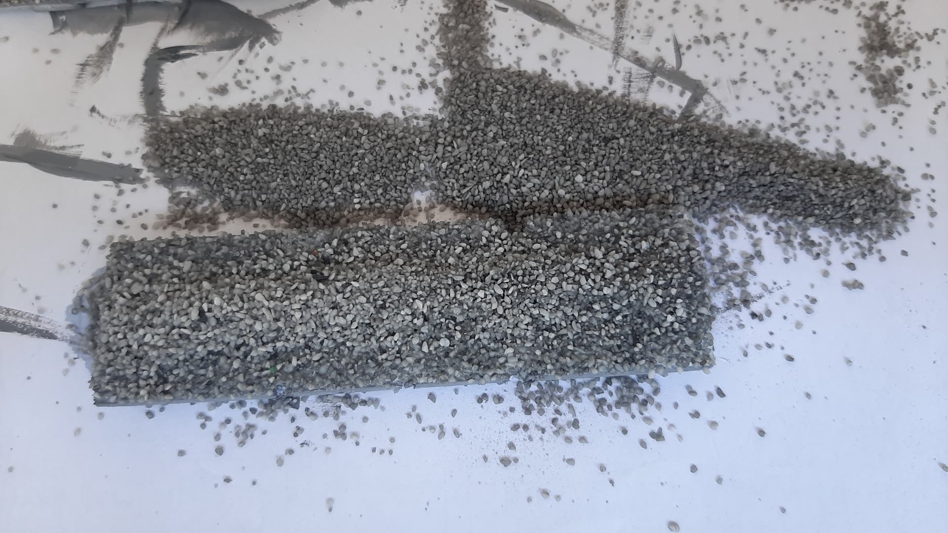

I repurposed some old hopper cars for my proto-free shortline railroad, to carry ballast.
I made a base with balsa wood, applied white glue, and added ballast, about halfway up the hopper.
