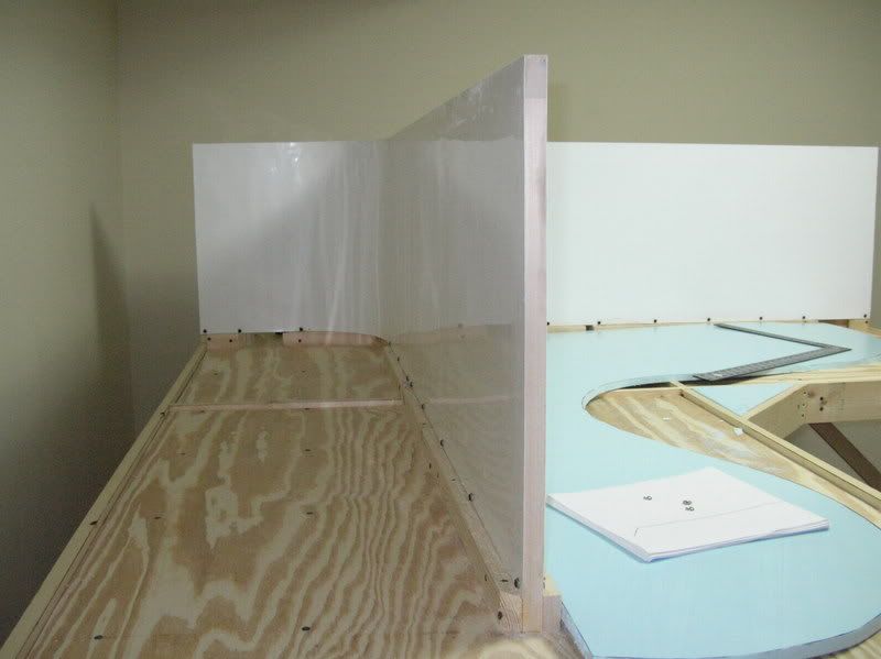

My double-sided backdrop is 3/4" thick. It’s made out of vinyl flashing with 1x2 supports. It is very sturdy, although I wouldn’t want to stand on it. Here’s a pic.
