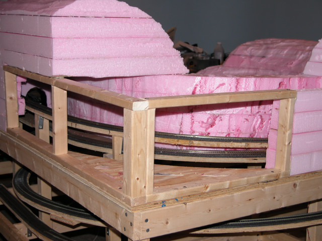

Yes, I call it Horseshoe Mountain, for obvious reasons. It is large. It took more than 4 sheets of 2" foam to create and has a removalable lid to work inside (and for derailments). Here’s a look inside with the lid off:
I agree the one thing I am learning most about this hobby is to not worry about mistakes. Just redo them or cover it up. Both work. As an example, I had to cut away foam to fix a chronic derailment problem inside the mountain. So I decided, why not use the oppoortunity to add a way to view trains as they run through the mountain so I ended up cutting away a corner and will put a view window through the facia.
It will be the perfect height for kids.

That cutaway is one good idea. How are you going to landscape inside? I’ll be waiting a pic. The TV artist always says, “There are no mistakes, only happy accidents.”
Have you tried carving rock formations directy in the foam. I am practicing and having some good luck.
Other than painting the foam black, I haven’t decided on how to landscape inside. I am not planning on lighting it and just let the lights from the trains be the lumination. I might put down some grass turf on the plywood in the corner and plant a couple of trees. I am open to ideas. I wasn’t planning on trying to do the true inside of a mountain. Not sure how fun rocks and dirt would be.
