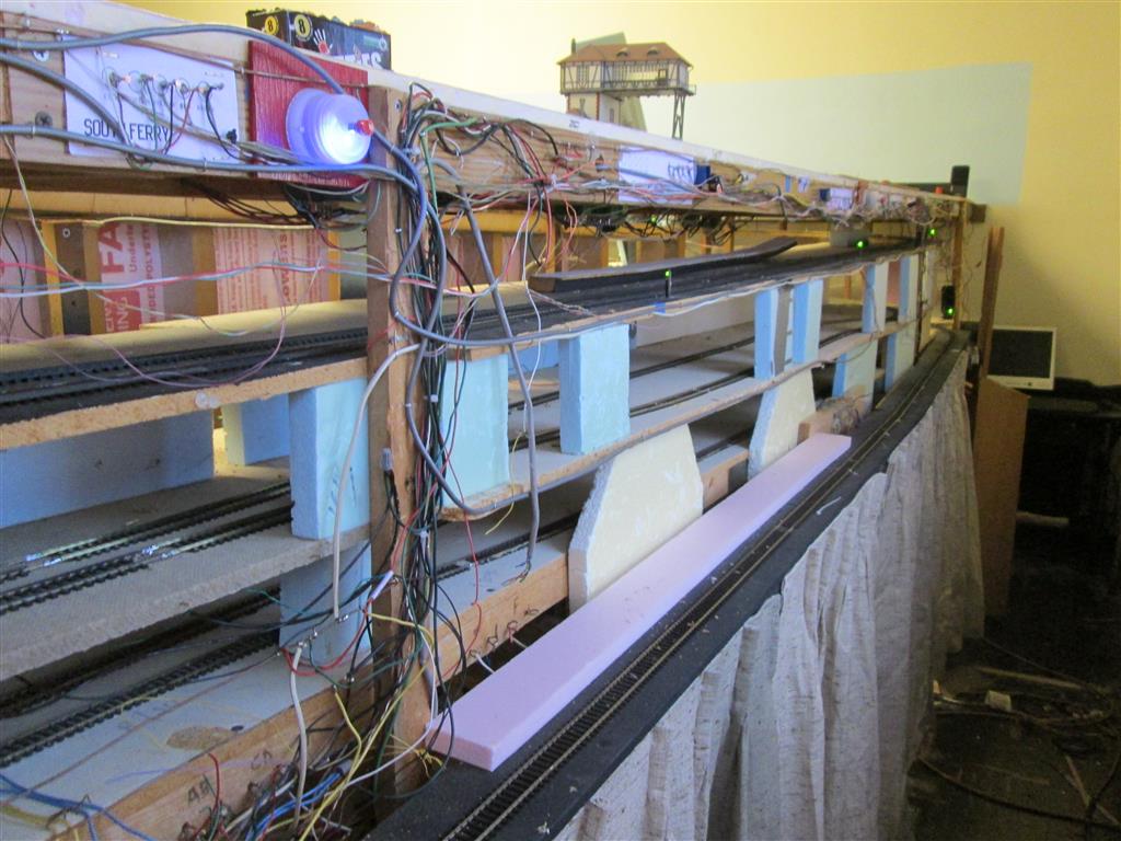

Train room of LION is 24’ x 27’ and runs on three levels.

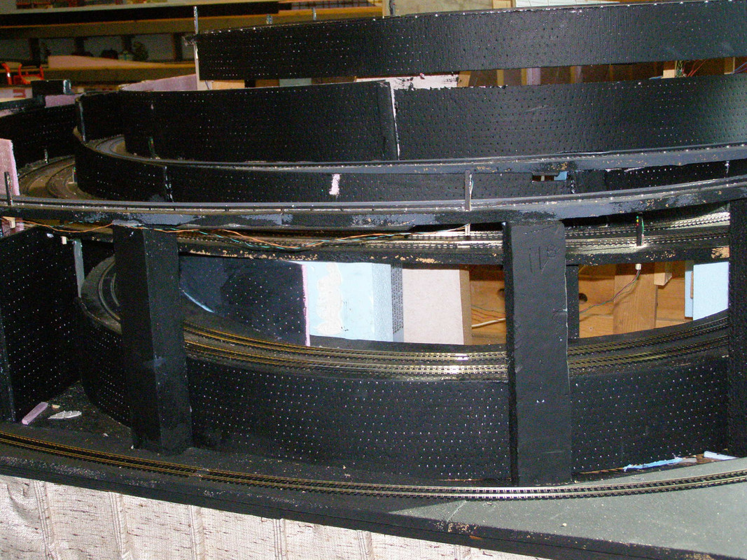

This is ‘back stage’ on the layout. Toto I think there are more than three levels here!

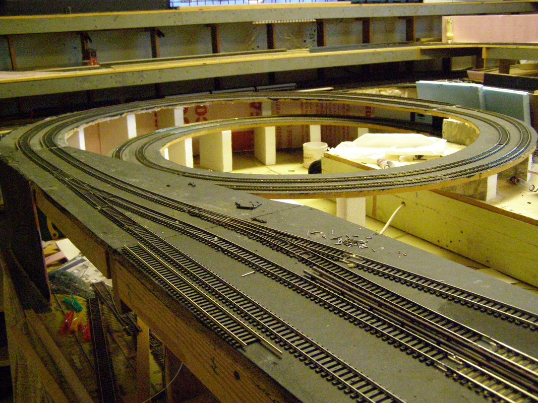

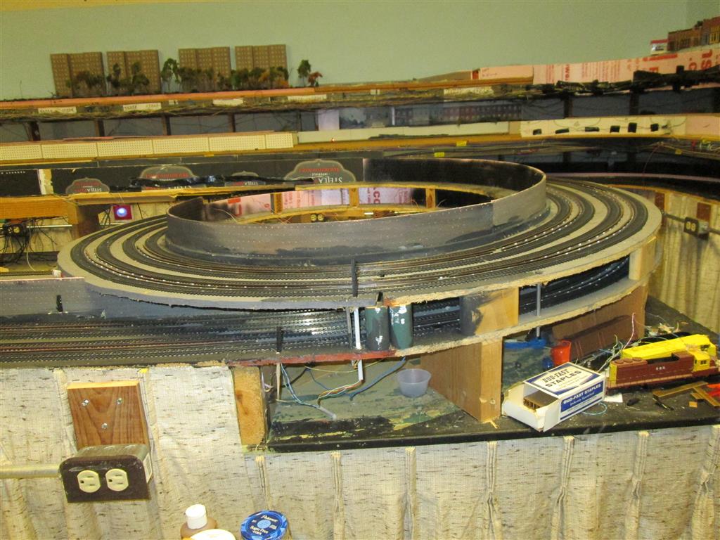

And the main helix. (the other helix is part of that monster above.)
Most of the ‘scenery’ is painted black… after all you are supposed to be inside of a subway tunnel.
