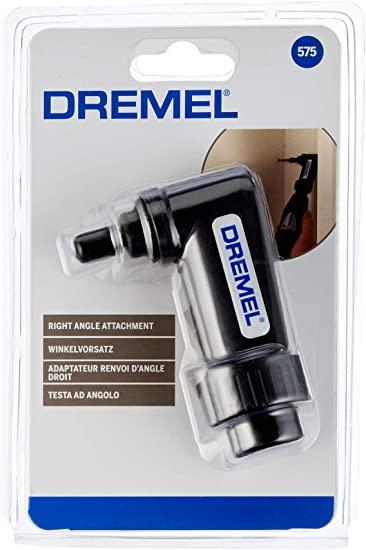

If you have a Dremel tool the angle head attachment with a cutoff disk works great.

That’s why I bought the Dremel angle attachment, with the angle attachment you can make perfect straight cuts.

If you have a rotary tool the investment in an angled head will save time.
