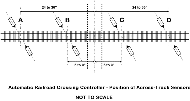

if an infrared led and phototransistor pair is used, could they be mounted an inch or so above the track and at an angle to cover a large section of the track to indicate if a car is located anywhere on the turnout?
similar to the figure below but at a smaller angle (less perpendicalar).
