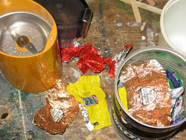

here was an article in the NMRA Bulletin Nov 1997, Tom Persoon, Modeling crap aluminum bales. He used the wrapping of sweeties, candies and others. Easter is coming! Collect the wrappings. I did this over years. I’ve used the covers from yogurt cups, too. They’re more heavy.
And you see an old coffee grinder. It has its second life in the basement.
You can get the desired fineness, grist. Just let the grinder work longer.
And here it is used:
Wolfgang
