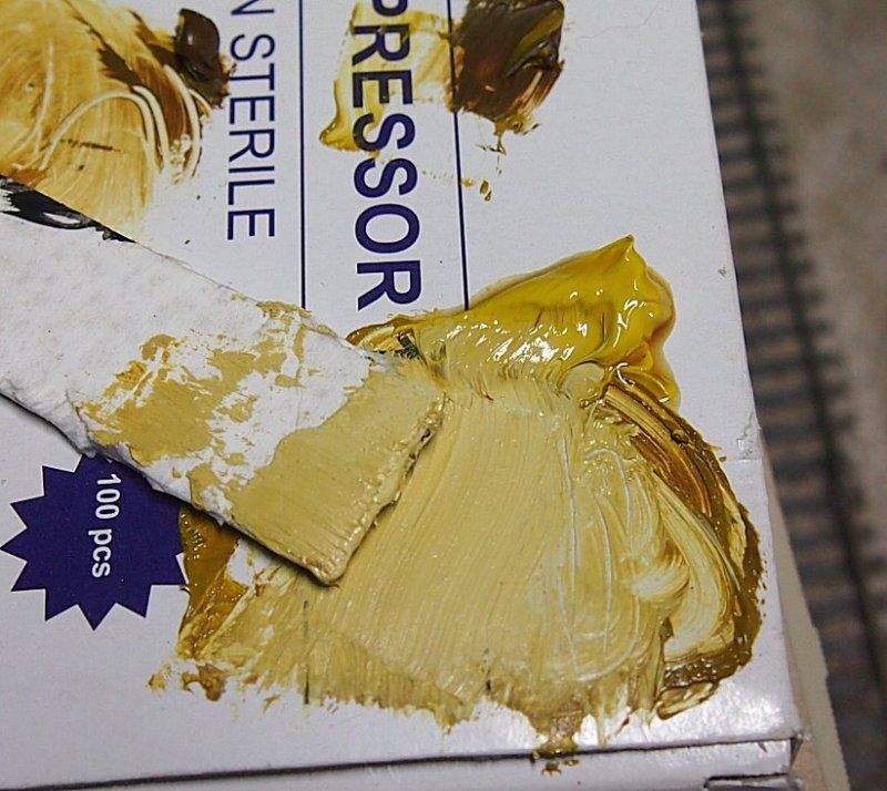

For this sort of mix I’d go with two yellows - one option might be Arylamide Yellow [bright yellow] and Raw Sienna [dull yellow] + white which gave me this:
The raw sienna will do the job of taming the other yellow, while giving it a different flavour of yellow that greying with yellow’s complementary colour [violet] won’t provide. It would depend on the brand of paint too, because they vary. Yellow Ochre may well do the job when mixed with a bright yellow. Again, dependent upon the brand, Naples Yellow is similar in hue to the example you showed.
