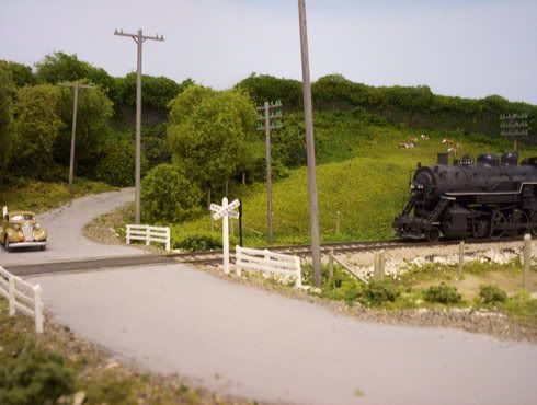

For “wooden” crossings over my Atlas code 83 track, I use strip styrene, distressed with a razor saw and painted an appropriate colour. Between the rails, I use four strips of .080" x .125" stock, glued together and then cemented with suitable solvent cement directly to the ties. The .080" height puts the top surface just below the railhead, and the .500" width sits neatly between the spike heads, leaving an ample flangeway. On the outside of either rail, I glue a strip of .040"x.100" on the flat directly to the top of the moulded spike heads, then abut that with another strip of .080"x.125", also on the flat.
Here’s a different view of another crossing. The road surface is drywall joint compound over patching plaster.
You can make easy dirt or gravel crossings by replacing the two middle boards between the rails with suitable scenic materials, and either use the same material on the outside of the rails or keep the boards. This picture’s the best I have at the moment to illustrate this.
I do paved crossings and street trackage using plain .060" styrene sheet in place of the strips, building-up the thickness between the rails with strip stock glued directly to the ties.

doctorwayne, very nice crossings…and layout.
Rick
Doctorwayne, beautiful layout the crossings are awesome hard to notice them as the beautiful layout was a distraction looks great!
Hey, Doc! Let me add my voice to those who say, “Super modeling!”
-Crandell
great shots of a great looking layout Doc.

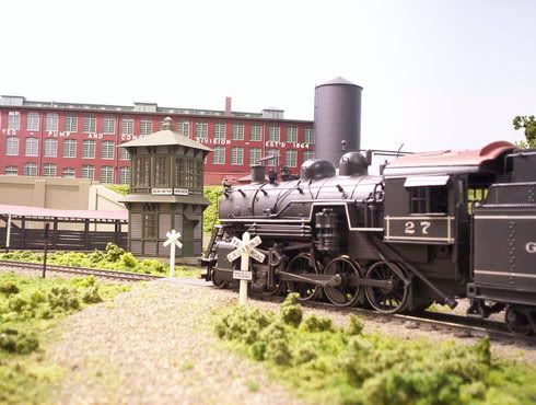

And for those who’ve never heard the adage that “if you ignore him, he’ll go away”, here are a couple more photos.

Very nice crossings guys and good tips for building them.
Doc-I like your industry scenes,especially the shot of the background structure in the second to last photo.
Jeff-If that car at the crossing decides to back up,he’s in for a BIG! surprise.[:D]

Thanks, Bill. Here’s a shot of the same building, taken from a different angle.
