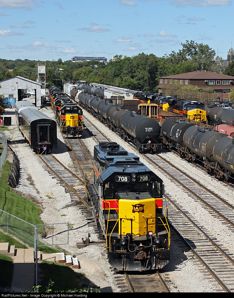

I understand what you guys are saying here, but when I look at protoype photos on railpictures.net, they all don’t have ground views, in fact a lot of them are shot from some point of view on a bridge, or hill or something.
Like this one here…
Motley, you’re right on: not all railfan shots by any means are from ground level. However, the model shots we take which are supposedly from ground level are sometimes (not all) really from 10-20 feet up. I’m just suggesting a way to improve that position a bit. And I’m NOT knocking anyone’s photos or modeling, particularly Dr. Wayne’s. They are most all better than mine by a long shot (no pun intended).
