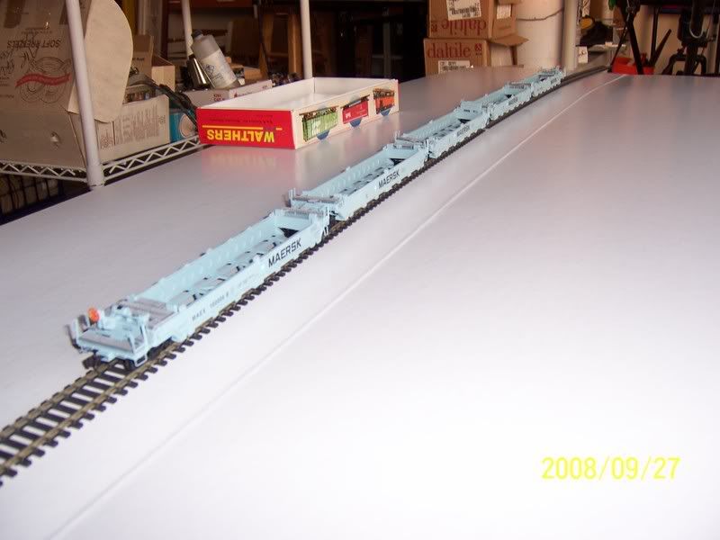

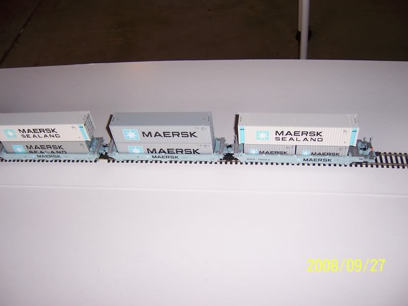

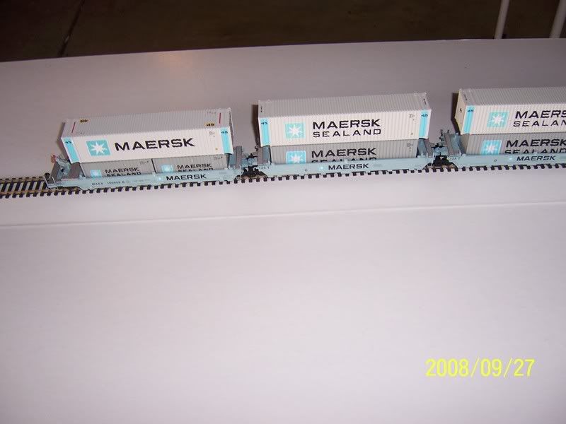

Thanks for your 4 months of patience!This is the completed Maersk Maxi I car:

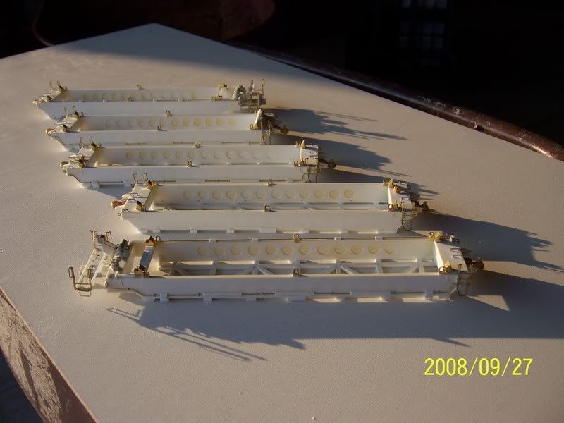

and the TTX car just prior to “primering”. will post completed pics when done. Hopefully you can see all the shtuff I detailed on these from this picture. Remember I started on these in 2003.
