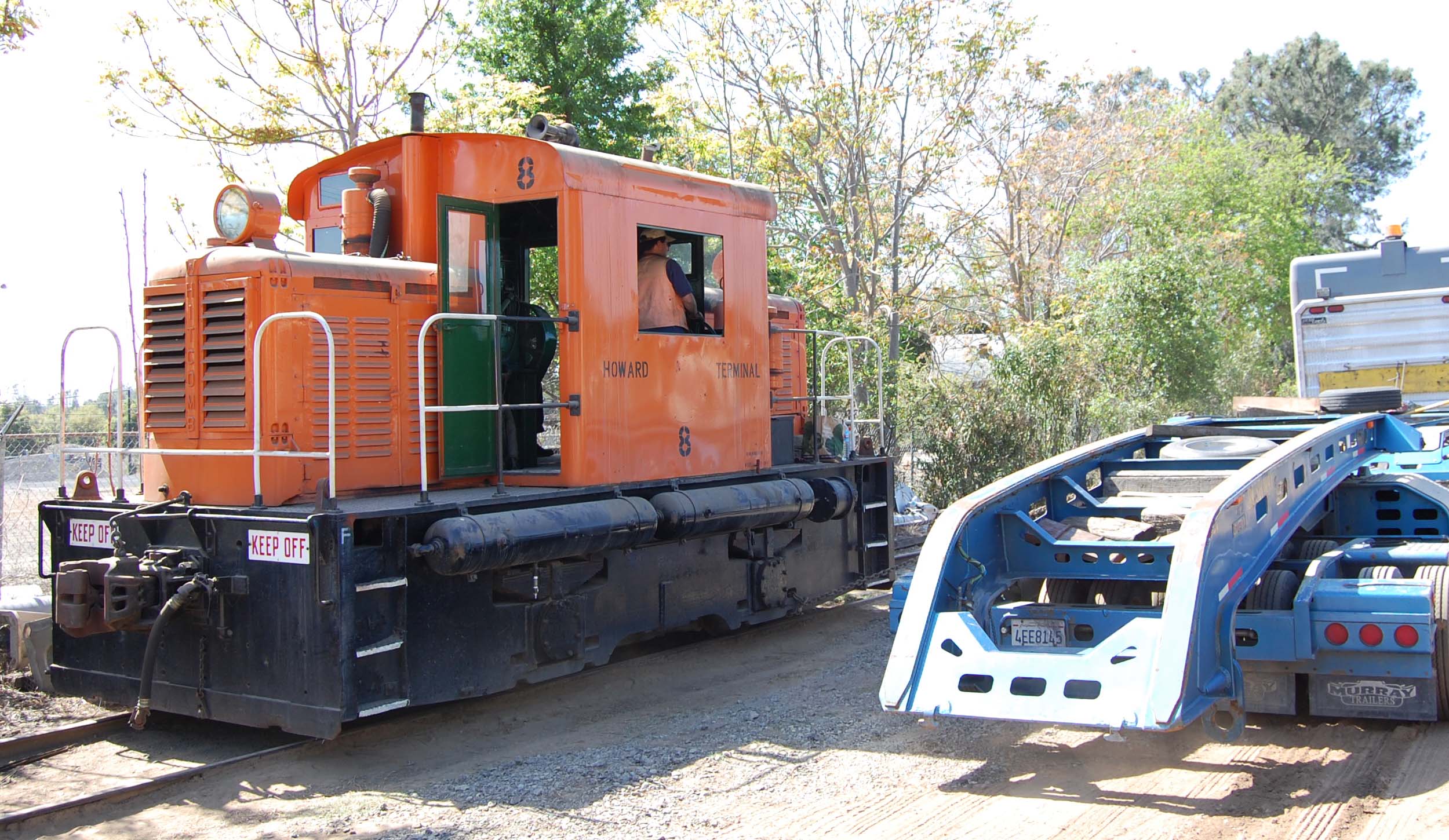

Here’s a photo of a Howard Terminal steam switcher.
The terminal is behind the photographer. Back in the seventies, I used to hang out just about under the bridge/trestle, over on the left. I photographed whatever came by on the SP main that looked interesting. And the WP, too, for that matter.
Hence, on occasion, I could look to my right and see this little guy coming out of the terminal:
Ed
Thanks for sharing, that’s really cool!
