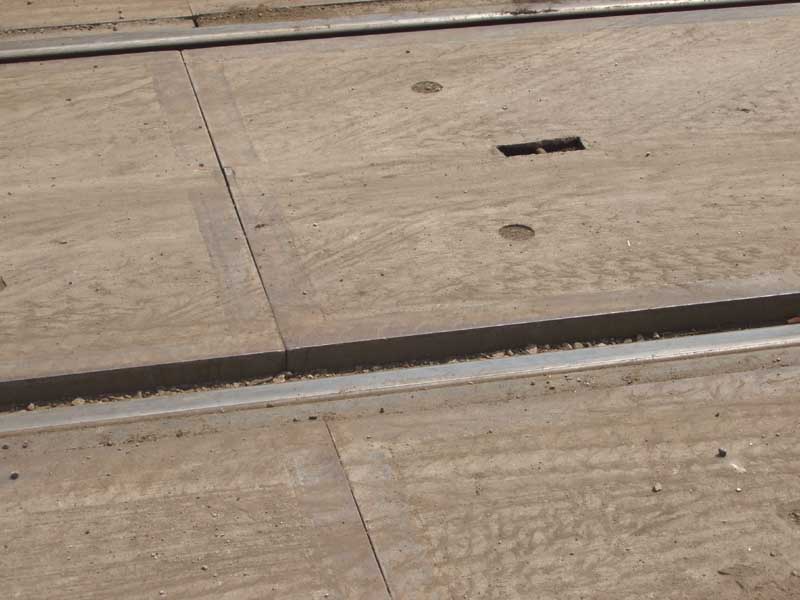

James, here’s another easy way to model a modern crossing. I took this pic about 10 days agon on a BNSF mainline. UP is doing the same thing.
is that just ply sheets ?
interesting…
That white stripe should be at a right angle to the road - not parallel to the track (no matter what the angle of the track). It’s the cars that have to stop at the white line - not the trains.
(The top picture looks right, the lower one doesn’t).

It appears to be angle iron filled in with concrete. Here’s another picture. Based on the slots in the concrete, it appears as though they might be prefab and set in place with a forklift.
(click to enlarge)
If you’re interested, I can try to get some more photos and some dimensions. It will take a while though since my camera died last week.
