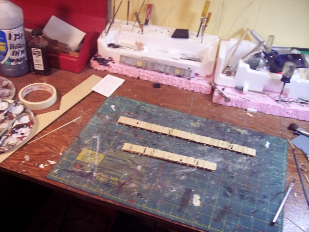

I’m working on one, along with everyone (almost) else that regularly attends the NMRA division meetings. We get together every second month, have clinics and continue construction.
So far, so good. I’ve painted and sanded the walls. You want the walls flat and square to make assembly easier. The kits we’re building use butt joints, so bevelling one edge makes it easier to make the joint. (Wood is actually used to make the joint, so a tight fit isn’t really needed for bonding at the joint.)
