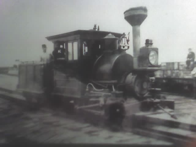

Here’s a photo of an Arcata & Mad River 0-4-0. I think it’s a Porter. There is an On30 model, but they also built them in standard gauge: this one was built for A&MR’s oddball roughly-three-and-a-half-foot narrow gauge.
