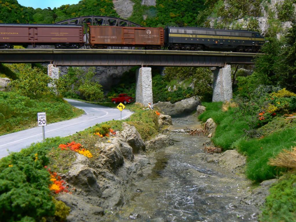

I used Magic Water for all my streams. Only con per above post, stream bed must be sealed. DJ.
Hammer Cr.

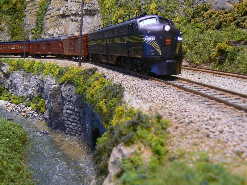

Roaring Creek.
Hi, Can’t beat Grampy’s for realism. Note how the river bends and disappears into the background, on both his photo and mine. The background on my photo is a commercial photo glued to the Luan backdrop. I suggest using Hydrocal plaster as the water proof base. I also, use Magic Water, but Envirotex is excellent also. I will never use WS water. Both Magic Water and Envirotex have a tendency to creep up the sides slightly, but that can be painted over, when the third pour dries. WS Water Effects is excellent. for rapids and waterfalls. The last Dream-Plan-Build DVD shows how to build waterfalls. Bob Hahn
