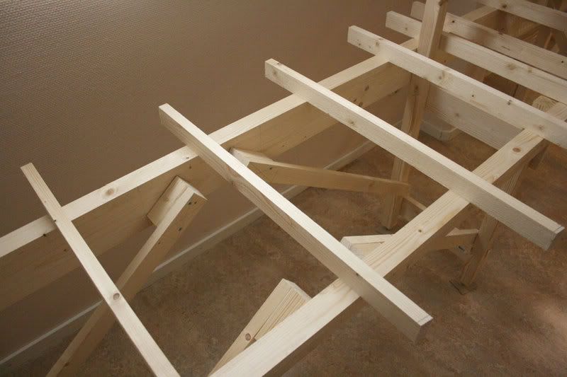

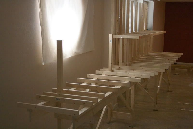

I have made some progress with my benchwork. Lots of work left to do but it’s always a start.
Guys!
Well, that looks darn professional. How will you transition to the upper level ?
Good looking bench worjk. Good looking room it sits in. Soon you will need trees. Thanks for sharing

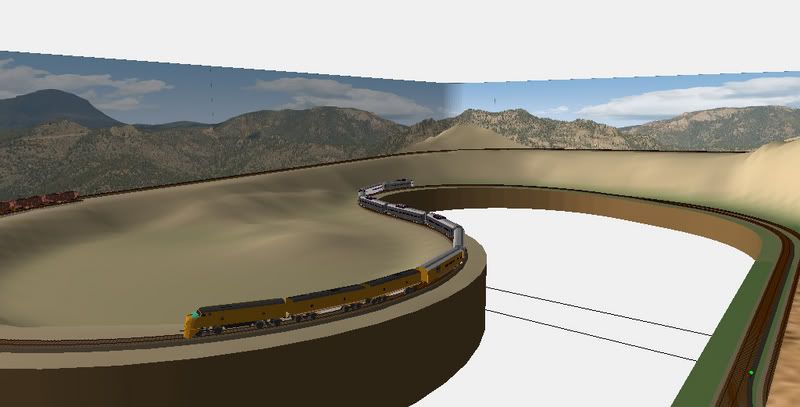

The transition to the upper level will be like this:
My track plan is located at www.thrutherockies.com
Here are two more pictures:
I like the benchwork so far. I have read so much about carpeting helping on the back and feet in the train room but like you I am planning on putting hardwood down in my trainroom. Should make it easier to clean up after working on the railroad.
I also like your website. Very professional looking and thought out.

What part of the track plan is that benchwork?
What wood did you use on it?

Why does that L-girder benchwork look so familiar? [swg]
Safety Valve,
The benchwork you see is Denver North Yard on the trackplan. The wood I’m using is 1 x 4" and 1 x 2" for the L-girder. 2 x 2" for the legs and 1 x 2" for all the rest. I’m using regular drywall screws. L-girder is glued with white glue (CASCO).
