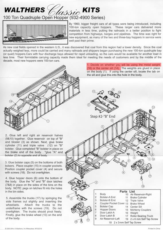

Magnus, I don’t see why it should be an “either-or” question. The only option should be the centre sill…maybe, since I have not seen these, nor the instructions for their assembly…but the weight is not meant to be optional if you want a car that conforms to a weight standard in HO.
Is it possible that the order of assembly is backward? Have you possibly misunderstood exactly where the weight is to be attached? If I form a vision, the weight would be either under the car body, inside the frame (?), or lining the bottom of the hopper with the sill slid down guides on top of it.
Just my take on it.
I scanned it for you all to see what I mean.
