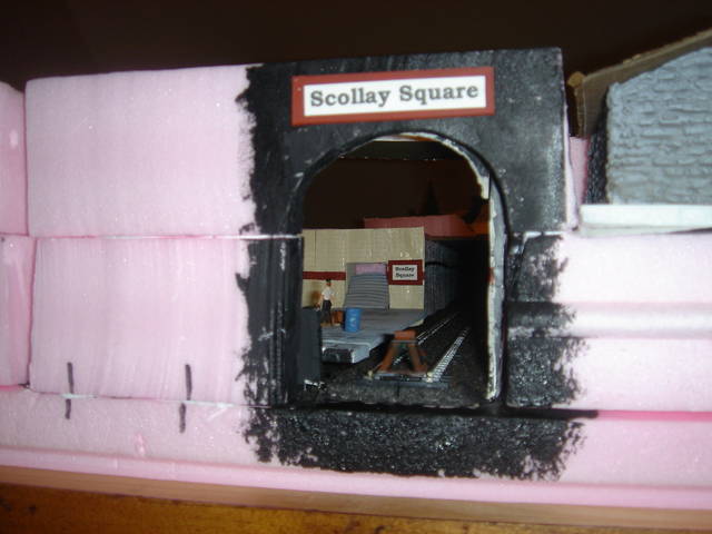

I also use my computer to produce signs, mostly for on-layout applications. But, the same techniques can be applied to the fascia:
The “Scollay Square” sign was printed on cardstock using an ordinary inkjet printer. I cut a piece of styrene for the border, and painted the edges to match the color scheme of my subways. I left the center of the styrene backing unpainted, so the glue would have something better than paint to adhere to. Then I glued the sign to the backing, and the backing to the edge of the layout.
